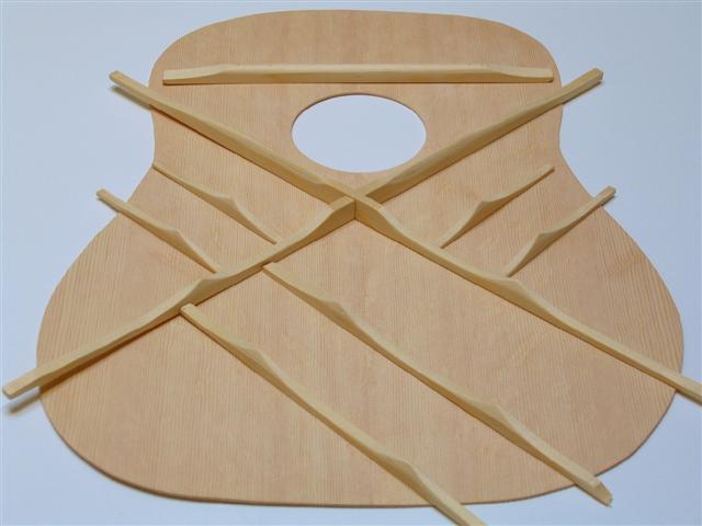

This is my first post here and I wanted to say Hi and thank everyone for the great help and inspiration that I have gotten from the forum. Im building my first from an LMI kit and its going better than I would have expected. Its a cocobolo dread with a bearclaw sitka top.
In an effort to protect the soundboard from my chisel (I'm new to chiselling) I have done a lot of the shaping of the braces before I glue them. I thought I would get some opinions on them as I really have no idea and if they seem too thin in places or have some other issues , I could redo them. I have a lot of great brace wood stock as well as a great lutz top for my next one from Shane. The photo doesnt include the soundhole braces or the upper transverse graft.
The top is about 1.10-1.15.
Thanks for any advice,
Warren

Hi Warren,
Welcome to the OLF. What part of Canada are you located in?
That looks like a great start for a first. I'm sure if you glued it down (don't forget the bridge plate) that it would come out sounding like a guitar.
It's very hard to make to many comments by just a visual on bracing. Many of us like to flex the top to see how stiff it is when we compare it to other tops and once the braces are on, we like to tap the system to see what it sounds like. Some like it to sound like a tight ping, kind of like a glass which is almost full of water, some like it to "thud" a bit more and sustain kind of like a glass with little water in it.
But taking a look at what you have there, you will certainly produce something that sounds like a guitar should. But what for certain it will sound like is much to subjective and impossible to tell from just looking at a picture.
Keep up the good work and keep us posted on your progress, we kind of like that around here.
Again, welcome. Don't be afraid to ask questions when you have them.

X braces are scalloped back quite a bit on lower bout.
 I did the same mistake,carving too much first, Id glue on the rough braces first, but you need pencil marks to show where they will go.
I just carved a top,and will be doing another this weekend.
You have to flex the top and listen to it as you carve.

Looks like a great start. You can carve your braces more once they are glued on. I place a layer or two of purple masking tape (it is fairly thick and low tack, I get it at Canadian Tire) along side the braces I am carving, that way if the chisel slips, it hits the tape and all is fine. Once you start tuning things up you will want the tape off and then you are do lighter work and you will need to be cautious. Keep it up and Welcome...Officially, to the OLF!! Now that you are posting that is!

Welcome, Warren. I also question the practice of scalloping before gluing to the top plate...something to consider on #2.
A few observations:
1) The peaks on the tone bars seem way too close to the lower bout's edge. I'd make new ones and scallop according to how the top wants to vocalize. Personally, I would like to see a more gentle taper as it becomes thinned out to nothing before reaching the edge.
2) After gluing down the x-brace, place a top cap at the junction to lock it in and make it stiffer.
3) During voicing, you should be able to thin out the areas of the tone bars and finger braces where they touch the x-brace.
4) Don't forget one of the most important braces of ass...the bridge plate! What are you planning to use?
5) If you're planning to use HHG, try heating up the gluing surfaces before applying the glue. It will give you a lot more open time. I actually microwave the x brace assembly for about 15 seconds....others place it on a warming plate.
Good luck and keep asking!

A few more things...
1) what is the radius of the x brace gluing surface?
2) are you using a radiused dish...I would seriously recommend gluing up in a dish or some other curved setup so that you can maintain the proper curvature.

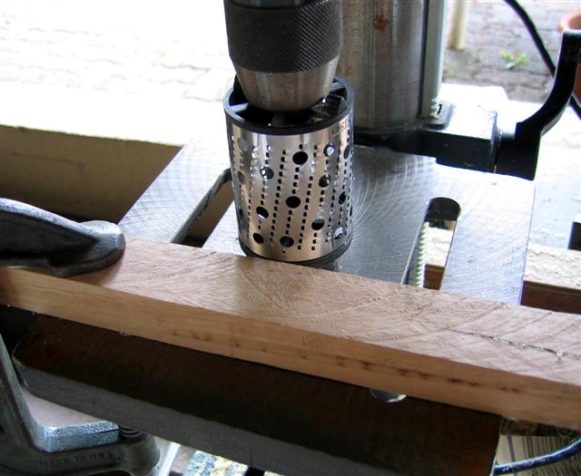

Hesh, I used a micro plane in my drill press to do most of the shaping as well as to rough in the radius on the x-braces before sanding in a 30' radius dish.
I have a rosewood bridgeplate yet to be cut.

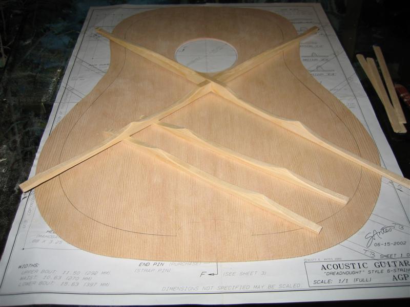

JJ, thanks for the advice. I didnt place the tone bars very accurately in the photo I posted. The top is still quite oversized as well so I have posted a photo with a line showing where the sides meet the top. I think I'll make another set as I dont have much thickness to work with and I am sure it will a good learning experience to hear how the tone changes with shaping.

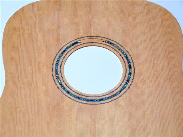

Thanks Peter. As far as I could tell LMI only cuts a rosette channel that fits the rosettes listed in the kits. The rosette I did was a simple one of black/white/black fiber and 3 pieces of their widest curved paua abalone abalam. I used LMI's .055 end mill in a dremel and can see a little tearout if I look very closely. Perhaps I went a little too fast but Im really quite pleased with it.

Yes I cut them all myself. I had LMI do quite a few things that I thought would be difficult for someone of my experience such as bending the cocobolo sides, thicknessing the soundboard and carving the neck. I really wanted an abalone rosette and I didnt read anywhere that they cut the channel to suit. I guess you could contact them to see if they do custom work like that, I never did talk to them. It didnt seem too difficult to do myself but I certainly wasnt in my comfort zone. I dont know if this is common but it looked like I messed up big time until I levelled everything out.
